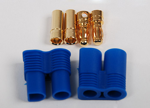

ec3.jpg [ 37.46 KiB | Vist 27636 ganger ]
